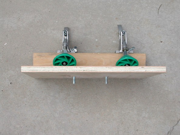

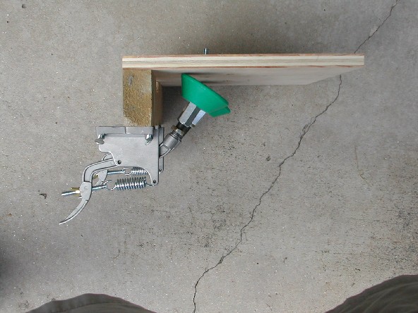

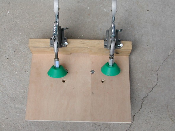

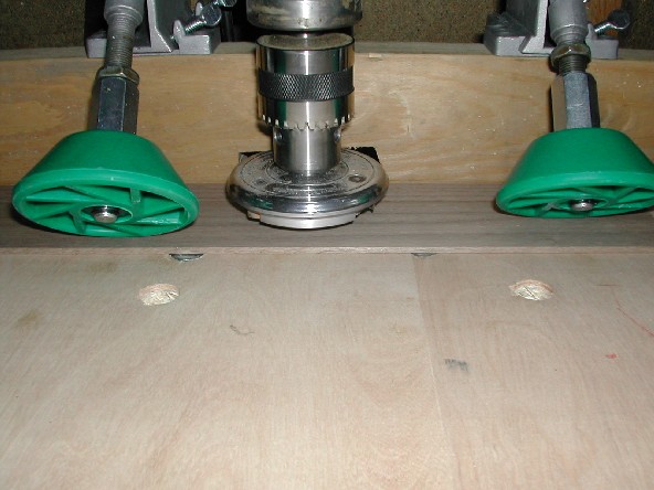

This is my solution to using a safety planer
Hope this helps. You can get these board buddies from woodcraft.com. Make sure you get the green ones as they roll both ways.
PostPosted: Sat Aug 27, 2005 9:35 am
Posts: 993
Tracy,
That's a great idea. What is the 24" track they are referring to on the website? Is that just a piece of wood to mount them to? The jig you have there looks great.
Cheers!
PostPosted: Sat Aug 27, 2005 9:44 am
Posts: 688
John,
That is Bruce's handy router jig for thicknessing. I was just showing another method for using the safety planer. Glad you liked it.
